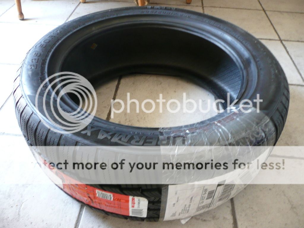

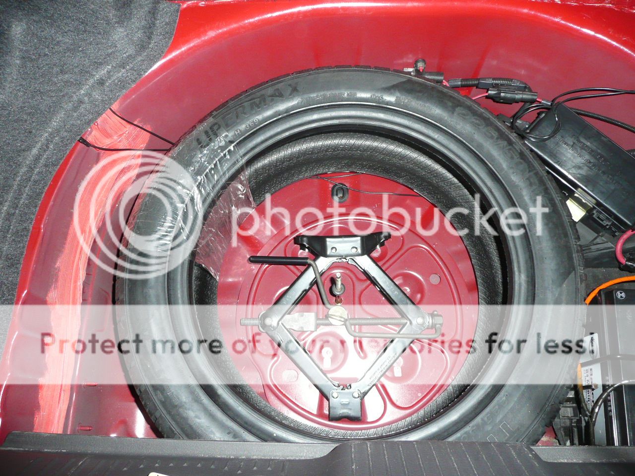

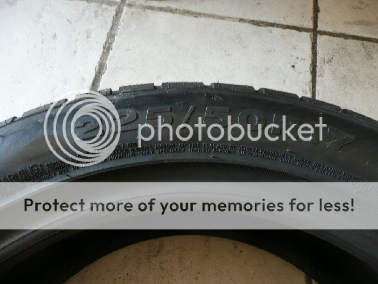

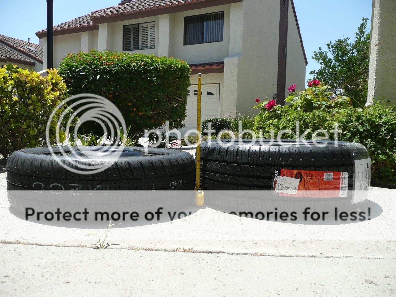

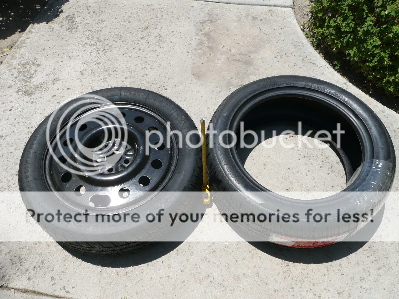

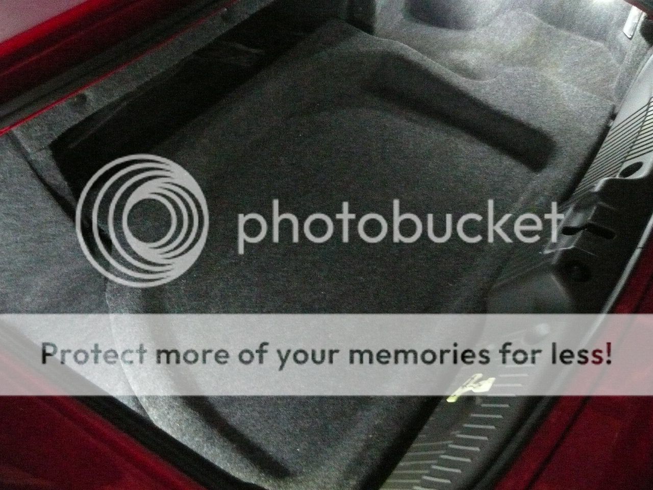

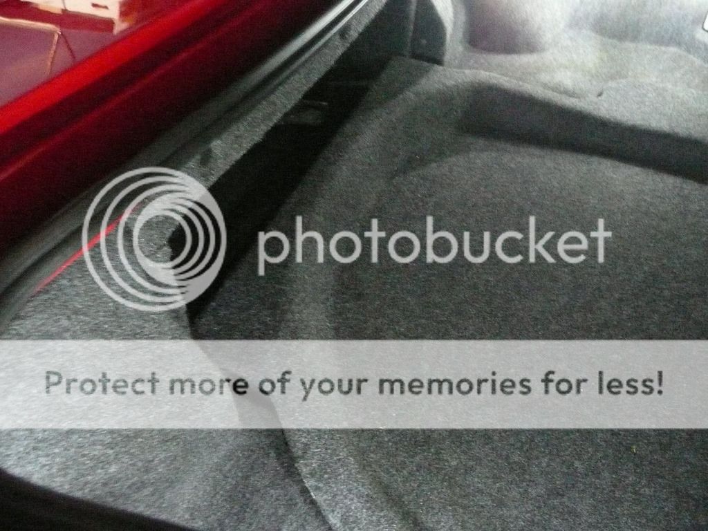

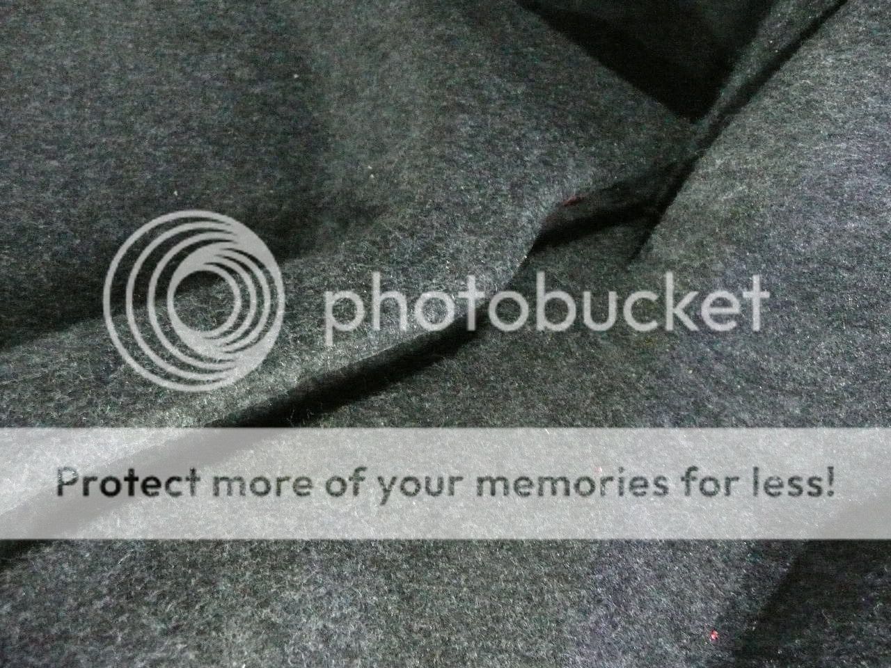

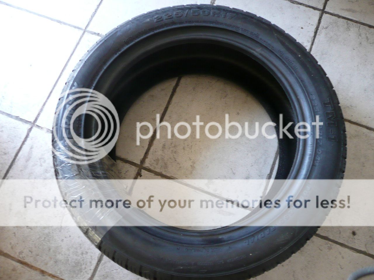

Someone brought up this thread last week from the dead, and I ran across it as I was searching for an alternate spare tire other than Maxxis. I previously had tried 215-55-17 tire as a spare, but it was wider than the 180-60-17 spare so the cover was hitting the tire and wouldn't sit flat with the rest of the trunk. OP Taz said he bought a used 225-50-17 tire and the cover didn't touch it, so I went ahead and bought a new tire from Walmart to try out, if it doesn't work then I can always return it hassle free. I already knew the 215-55-17 didn't work for me, so I was thinking why the 225-50-17 would work since it's much wider than the 180-60-17 original spare. Well, I received the tire today and obviously IT WOULDN'T WORK WITHOUT THE COVER HITTING THE TIRE!!!
The 225-50-17 is at least 2-3 inches wider than the 180-60-17, so when it sits flat on its side, it is at least 2-3 inches higher and the cover will hit it. It will raise the cover at least 1" higher all around. On my way to Walmart to return this brand new tire. DO NOT WASTE YOUR TIME TRYING THE 225-50-17 AS A SPARE WITH THE HOPE OF THE COVER WILL NOT BE HITTING IT BECAUSE IT WILL NOT WORK. I ALREADY DID THE WORK FOR YOU!!!
